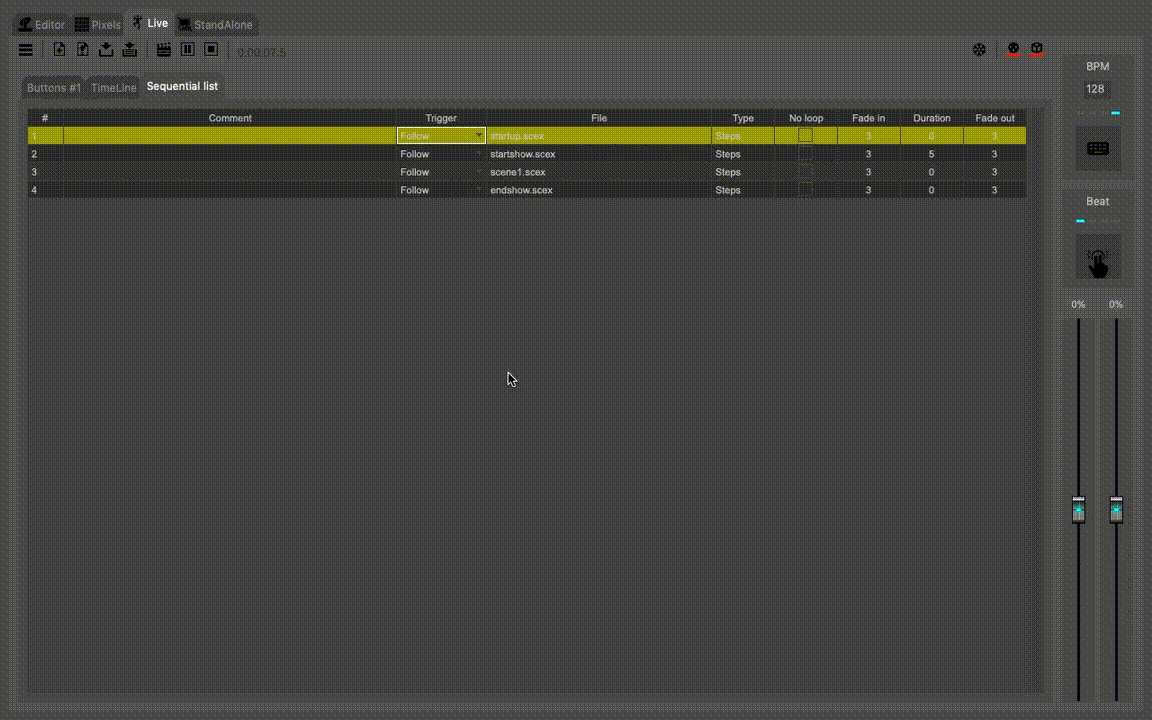

I'm trying to use the 'Wait for go' trigger, but it isn't working. When I click it, I get a window for making a new lightshow. How can I use the 'Wait for go' trigger?
I'm using MacOS Mojave (10.14) and using the latest version of Sweetlight controller. I also tested it on my Windows machine and there it is working without problems.
Thanks in advance

Hello, this problem is supposed to be fixed in the most recent software version.
Please try with version 9.1.9 (or 9.1.11).

Thank you! I installed the fix file and now it's working without problems!
